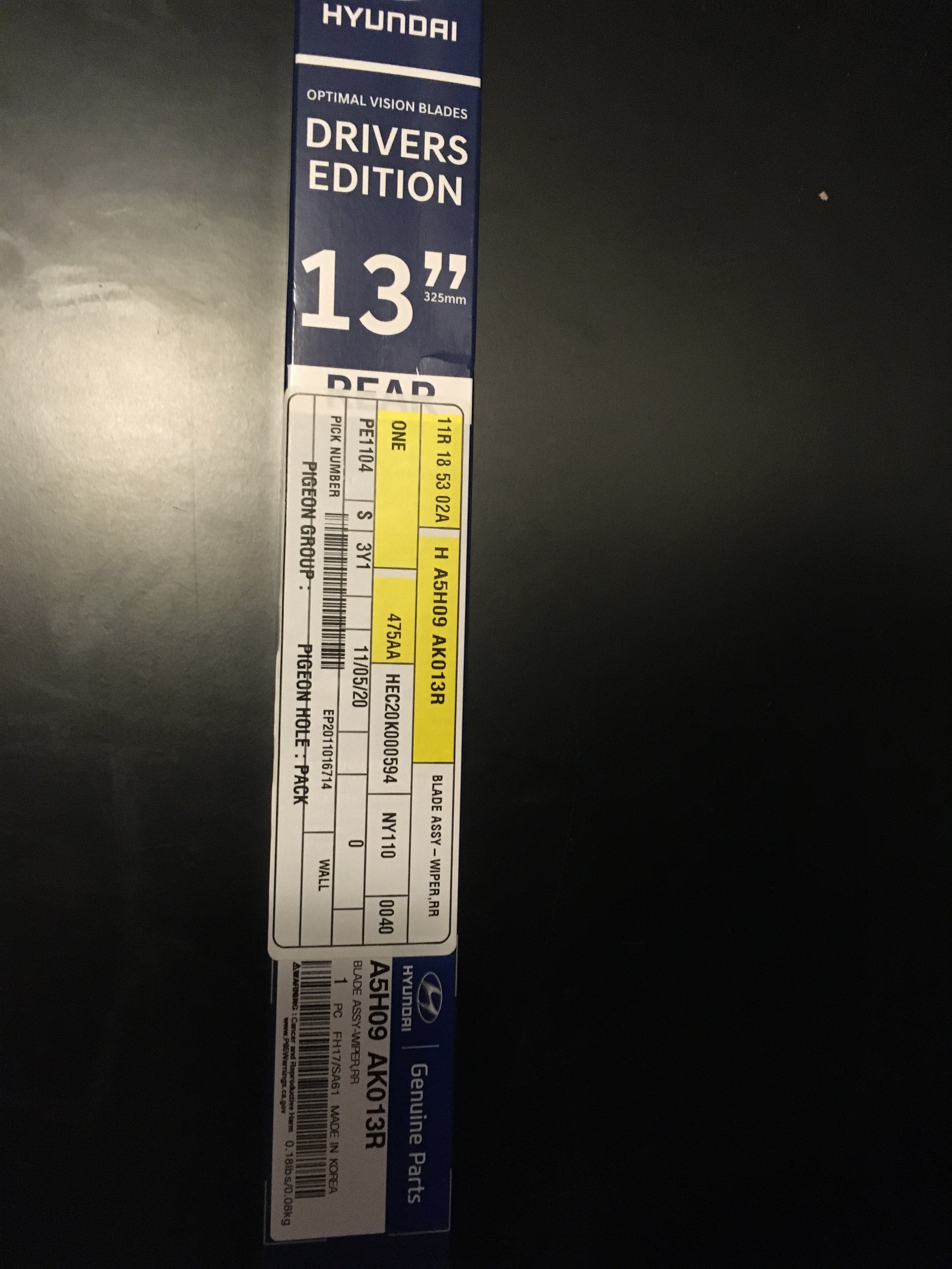

It’s easier than I first thought, particularly after browsing this topic. Lifting up the cover behind the pivot point is the key. You can then lift the entire assembly. The blade is held on by a 1/2” U-shaped claw. By holding the wiper arm with right hand and a solid jerk with the left, the blade will release. Putting new one on is easier done.
I bought one on Amazon but it was 12-incher and I wasn’t up to speed on the above process so I returned it. Found a 13” one on eBay with a better description for $8+ shipped free. (It also fit some Hyundai-models!!)

so I just replaced mine, from Orielly's I asked for the Hundai one, and the one they brought out, didn't have the formed clip on part, so I asked for a 2018 Stelvio, and they only had one brand in stock, Trico exact fit, and it works perfect.
