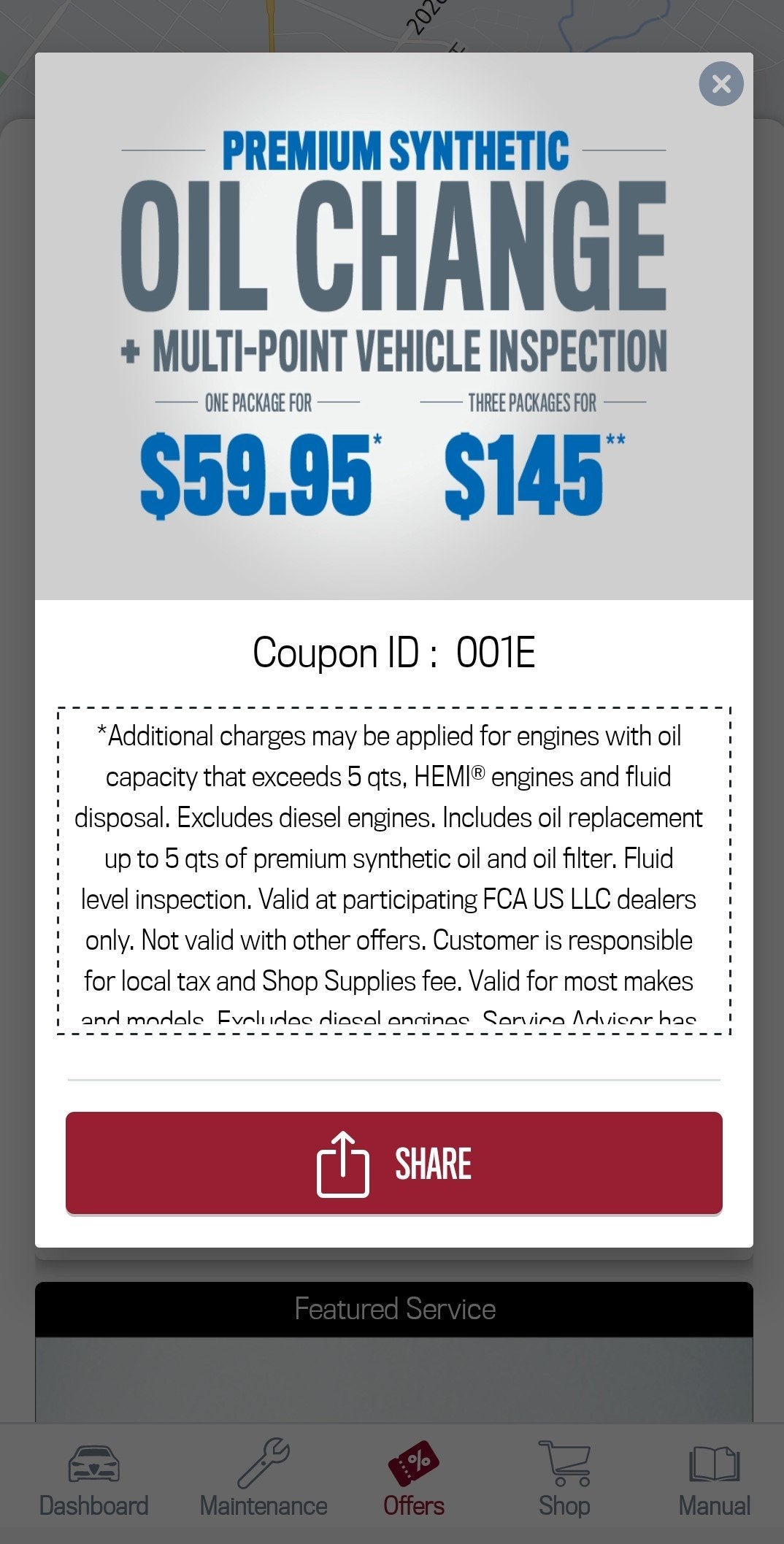

#24 ·
Just went on my app and found this.. try calling the dealer with the coupon code. My app is called My Mopar
Just downloaded app and registered my stelvio. I don't get any offers, but thank you for the tip. If I get something like this offer, I will definitely get it.:) For now, I ordered mobil1 and mopar oem filter.
